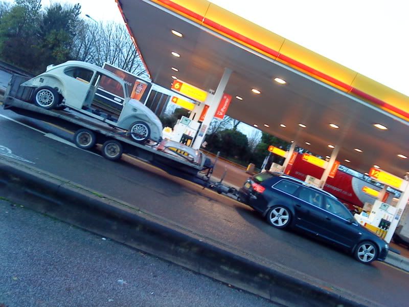

    OK so I have an 05 Audi A4 2.0tdi estate 6speed / 140bhp.
    All was well until I towed my 68 beetle to Cheshire and back (8hr round trip) on a large trailer for its restoration. When I got back I noticed the car was lacking power and smoky at low revs, thought it was because I had given it a bit too much of a workout and fuel was low, so I refilled with optimax v-diesel and then instead of getting better the emissions light came on!
