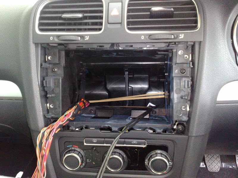

    This is how I fit my Clarion stereo in the Golf:

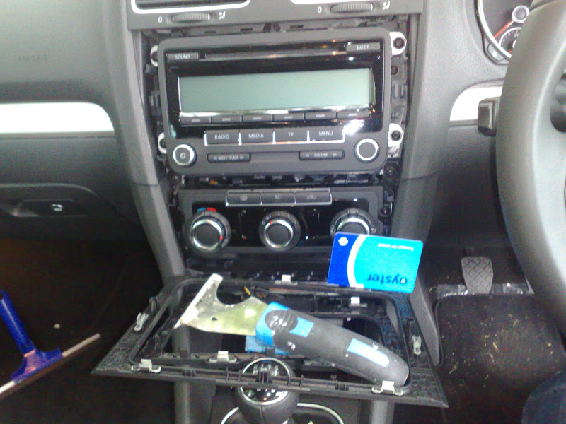

    Using my multi tool (pictured) - I pried off the surround:
    As you can see:
    Surround off:

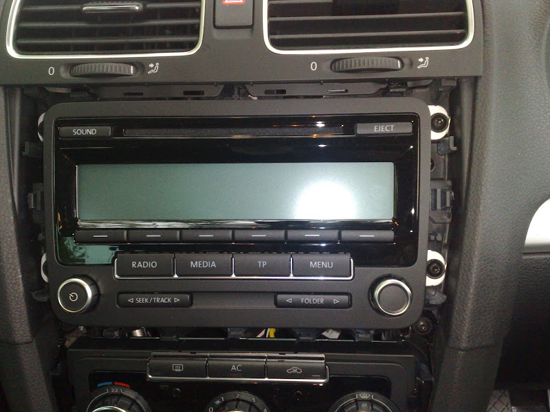

    The empty space:

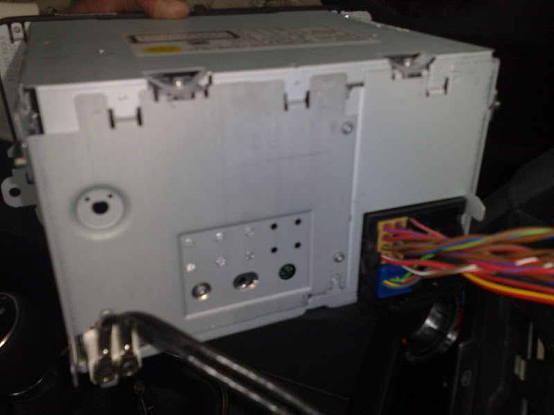

    The back of the stereo - As you can see, there's the Aerial adapter in the back as well as the CAN-BUS adapter:
    This is the back of my stereo with the CAN-BUS adapter connected and the relevant connectors all plugged in:

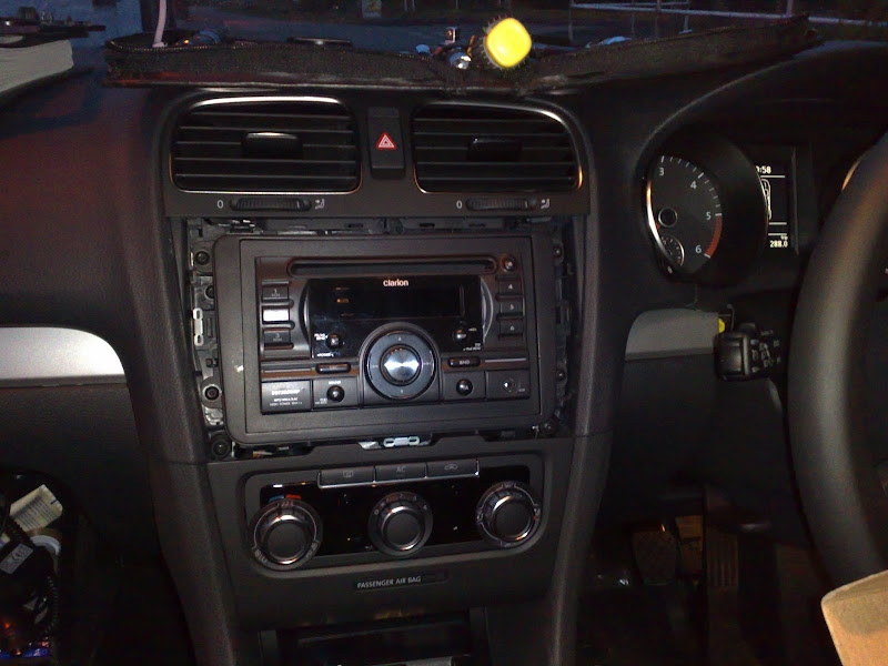

    Everything all slotted in but Fascia not on:

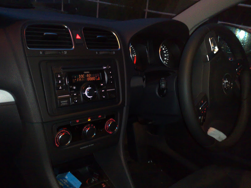

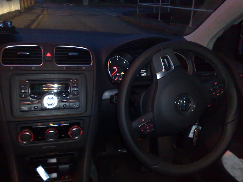

    Installed photo 1 - Sorry for the poor photo:
    Installed photo 2 - Not much better:
    I'll post up a better photo tomorrow.

    A daytime photo:
    The stereo has the added benefit that I can change the text colour to match. The audio improvement is remarkable - the sound that comes from the speakers is far clearer and fuller - and the OEM steering controls work with the stereo too

    Great photos! So you started by prying off the top part or side portion of the fascia?
    I want to diy my car as yours, just received mine yesterday. Enjoying the ride!!
  6. Re: How to (I) fit a Stereo in a Golf VI
    Nov 2007
    Scunthorpe
    2,561
    Hi,
    Thanks
    And I started at the left hand side - Note, however, that there is a slight chance that you might break off some of the retaining clips.
    If you look at the second photo down, you'll notice a gap in the middle between 2 retaining (silver) clips - that was where one of my clips was. It's still held firmly in place with that missing though so don't worry.
    It does snap off - don't think it won't, but it's worrying when you have to apply that much force to get it off.
    If you look at my photo, it might give you a good idea as to where to apply an appropriate level of force.

    The CanBus adapter gives you the options for a Speed pulse (which doesn't work - not that I'm bothered), Reverse signal (if I had a screen and camera) and a connector for OEM steering control:
