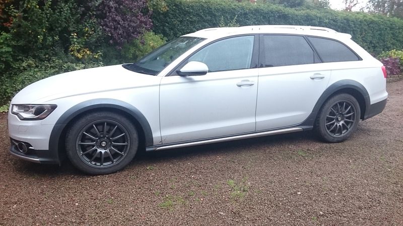

    I've temporarily fitted the 245/45 18s from my old allroad to my new one and set the pressures at 39PSI. The tyres are undersized (moreso as they are also worn) and are making a bit of a humming noise. I think I'll drop the pressures, but given that the avant is heavier than the saloon, and the allroad is heavier than he avant; can anyone confirm what the door sticker suggests for this size on a 3.0 TDI avant please?
    They don't actually look too bad despite being undersized, and I'll be fitting winters in about a month anyway, so it's a short-term fix for the next 1000 miles or so.

    Dropped down to 35 for a 300 mile journey. Don't think they look too bad, and only a bit small. 45 profile helps I think.

    Thanks. Forgot to stipulate quattro so you're about as close as I'm going to get.
    My journey showed a totally ficticious 47MPG and an additional 5% miles. I'm still trying to work out what's due to the reduced circumference and what's due to the aero effects of reduced section width combined with a lower ride height. The speedo also overreads by about 5MPH at motorway speeds versus GPS. I won't tell my wife.
